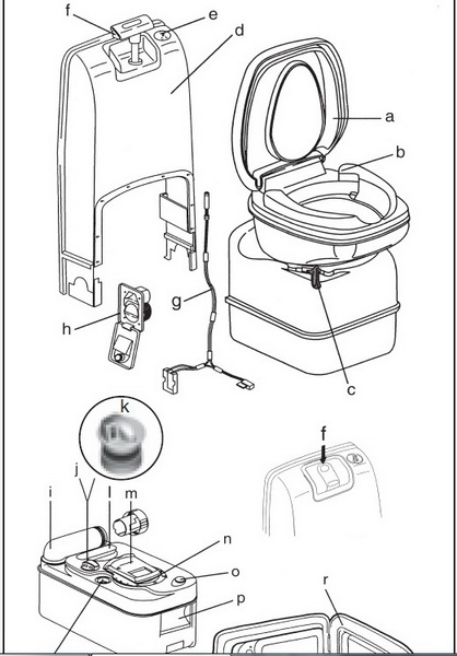

Am vazut ca WC-ul meu de la rulota THETFORD C-200 CW are un compartiment pentru 2 baterii AA care alimenteaza senzorul de nivel (g)
Mai este un sistem care ventileaza prin podea rezervorul colector cand acumuleaza presiune, probabil de la fermentatie la caldura se intampla asa ceva (j+k). Eu la acel sistem nu am vazut decat un arc si un dop cu garnitura, adica fix o supapa de presiune.
Intrebarea mea este, ventilatia prin podea se face natural sau mai exista un ventilator care sa fie alimentat la bateria rulotei? La bateriile AA nu vad din schema ca ar fi conectat si vreau sa stiu daca trebuie sa imi fac griji ca vor aparea mirosuri in rulota daca nu am curent in baterie.
C-200 CW / CWE PARTS AND FUNCTIONS
a.Removable seat and cover
b.Swivelling toilet bowl.
c.Valve blade handle.
d.Flush water tank.
e.Level indicator: warning light illuminates when the waste tank requires emptying.
f.Flush lever: the toilet flushes when the lever is moved up and down.
g.Power supply for the level indicator: two Penlite/AA 1.5 V alkaline batteries.
h.Waterfill door.
i.Rotating emptying spout: ensures that the waste tank can be easily and hygienically emptied.
j+k. Automatic pressure release vent: ventilates the waste tank when this is inserted into the cassette toilet. Avoids excessive pressure build up in the waste tank.
N.B. A black hose is attached to the automatic pressure release vent on some toilets. This hose transports the air to the outside through a hatch or through the floor.
l.Upper handle.
m. Cover: guarantees optimal hygiene. Opens when the
waste tank is inserted into the toilet and closes whenthe waste tank is removed from the toilet.
n.Valve blade / valve seal.
o.Vent plunger: for emptying the waste tank without splashing.
p.Handle.
q.Valve blade opener
r.Access door.

Danut, din ceea ce am citit, ventilarea se face fie natural, fie printr-un tub negru care trece prin podea (optional)"N.B. A black hose is attached to the automatic pressure release vent on some toilets. This hose transports the air to the outside through a hatch or through the floor."

Pentru evacuarea gazelor produse prin descompunerea deseurilor exista atat sistemul natural, prin acea supapa si un furtun, cat si un sistem care se instaleaza pe usita de vizitare, compus dintr-un ventilator si un filtru cu carbune activ. Acest sistem este optional si poate fi instalat oricand, nu este obligatoriu sa fie instalat odata cu instalarea toaletei.
